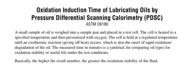

Forgot if I linked this or not… will tidy up with a couple more links to the tests in this barrage.
PDSC is a thermal oxidation test; higher result means oil takes longer to oxidize & therefore thicken.
