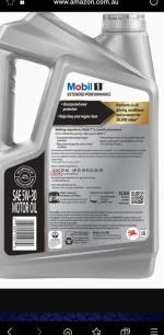

Had one of these at work yesterday. Luckily we had some M1 0w30 left.
Gf’s best friend has a 2020 KIA Stinger with 40k on it. She asked me bout what oil. I do have some M1 0w30 SM in stash left. Plan to use KIA/Hyundai OEM filter. Engine is 3.0 turbo.
