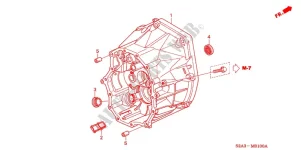

Some manual gearboxes have big magnets installed in their bottom from the factory. They serve as a "Lifetime " oil cleaner = metall particle catcher.
For Example, Nr. 2 in this Picture.
