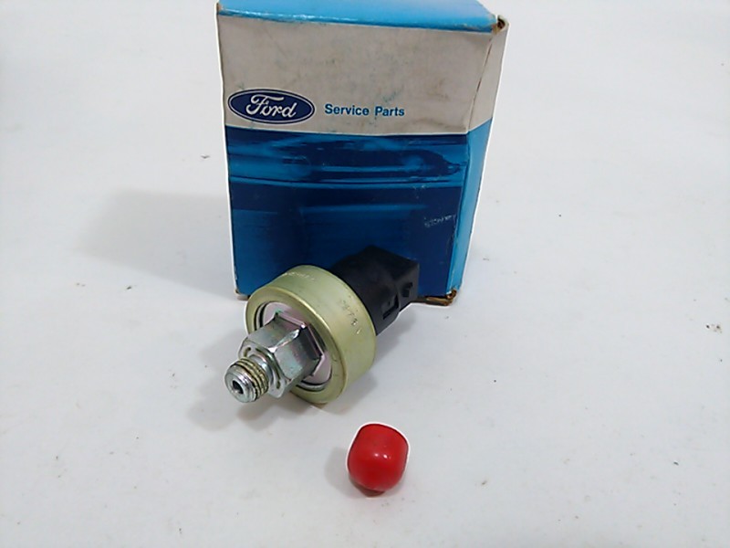

Does this power steering pressure switch need an o-ring?
Apr 27, 2010
18,611
Suburban Washington DC
1999 Taurus, old one didn't have one under it and a Ford part doesn't show it,
but some aftermarket switches do,
Should I put an o-ring on it? Can I use teflon tape or sealant as well?
The Ford part looks like already has a sealant on it. Do not use an o ring, if there is no groove for it, as soon as you tighten it it will spread out.
The Ford part looks like already has a sealant on it........

The sealer works well without causing installation issues. I use the Permatex 59235 a lot and never had a leak, if I were to use a sealing washer on something like this it would be an aluminum washer.
