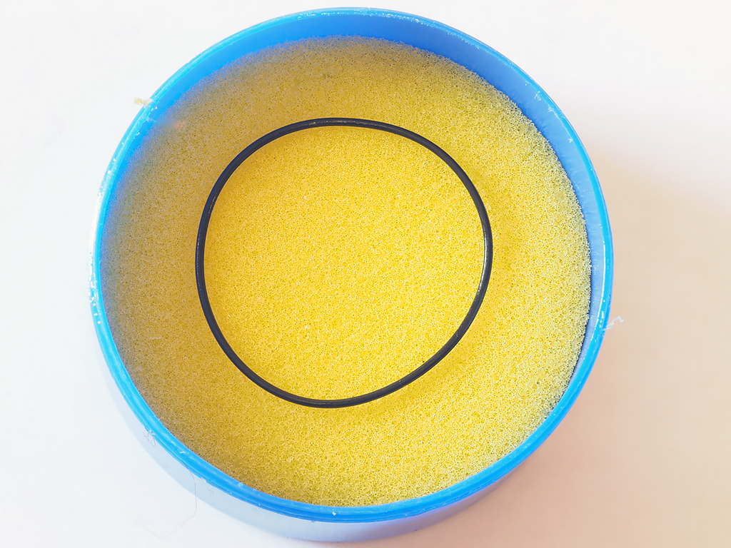

The o-ring must be super-clean out of its original packaging. You touch it only with plastic tweezers. You are supposed to use a special foam-lined container for silicone dressing application. Put the o-ring in the container, put the lid on, remove the lid, remove the o-ring that is now lubricated. Don't forget crown stem, crown, and pusher seals. After gasket replacement the watch should be tested with either a vacuum chamber or with a pressure tester/wet test.

Here are the spare o-rings and gaskets for some of the watches I own and maintain. Both halves of the blue silicone sealant container are foam-lined and soaked in silicone dressing. The round o-rings are for screwback cases, the squircle-shaped ones are for my Casio with a caseback that is tightened down with 4 screws. The tiny o-rings are for pushers (stems) on the Casio shown below. Imagine handling those with your fingers. In the same bag check out the tiny circlips that hold the pushers in the case. Tweezers!

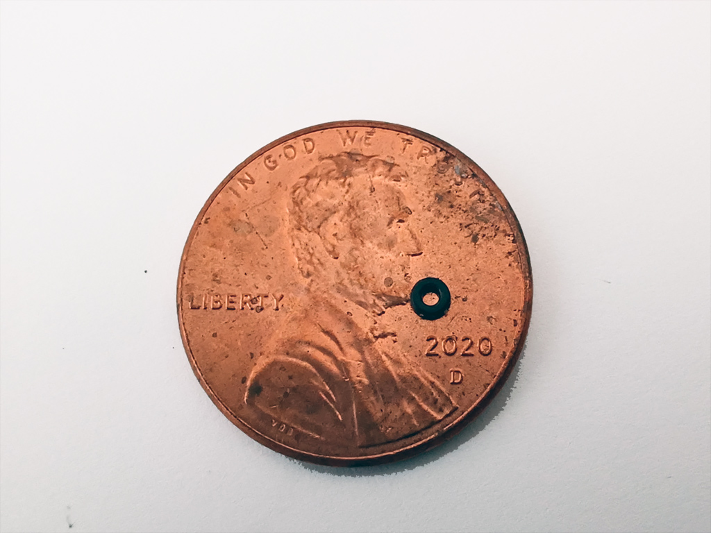

And a closer look at one of the pusher o-rings on a penny. You only need the tiniest amount of lube. Watch gasket lube is nothing like normal silicone grease in consistency. It has a much lower viscosity and leaves only a very thin film on the gasket.

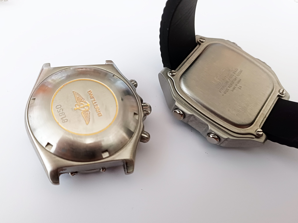

The Breitling has a screw-down caseback, the Casio has a caseback that is held on with four screws. There are also snap-on casebacks and two-part screw-down casebacks that avoid O-ring distortion. Then there's also the monobloc case, which doesn't have a removable caseback. You have to remove the screw-down crystal to gain access to the movement.
Snap-on and casebacks with screws usually can't offer WR beyond 100 meters.
Engineering-wise, the two-part screwback case in which the keyed caseback does not rotate during tightening down is the best option. Only the locking ring turns and pushes the caseback into the case. Ironically, this superior design is available, with very few exceptions, pretty much only on the Russian Vostok Amfibia. Off the top of my head, I can't even name one other watch brand that uses a similar system.

Without a foam applicator, I don't see a good way of applying an evenly-thin layer of lube or a very clean lube. Any particle on the gasket may compromise the seal. All that's needed is the thinnest layer of lube. You do not want excess lube to get squeezed out of the O-ring groove.
