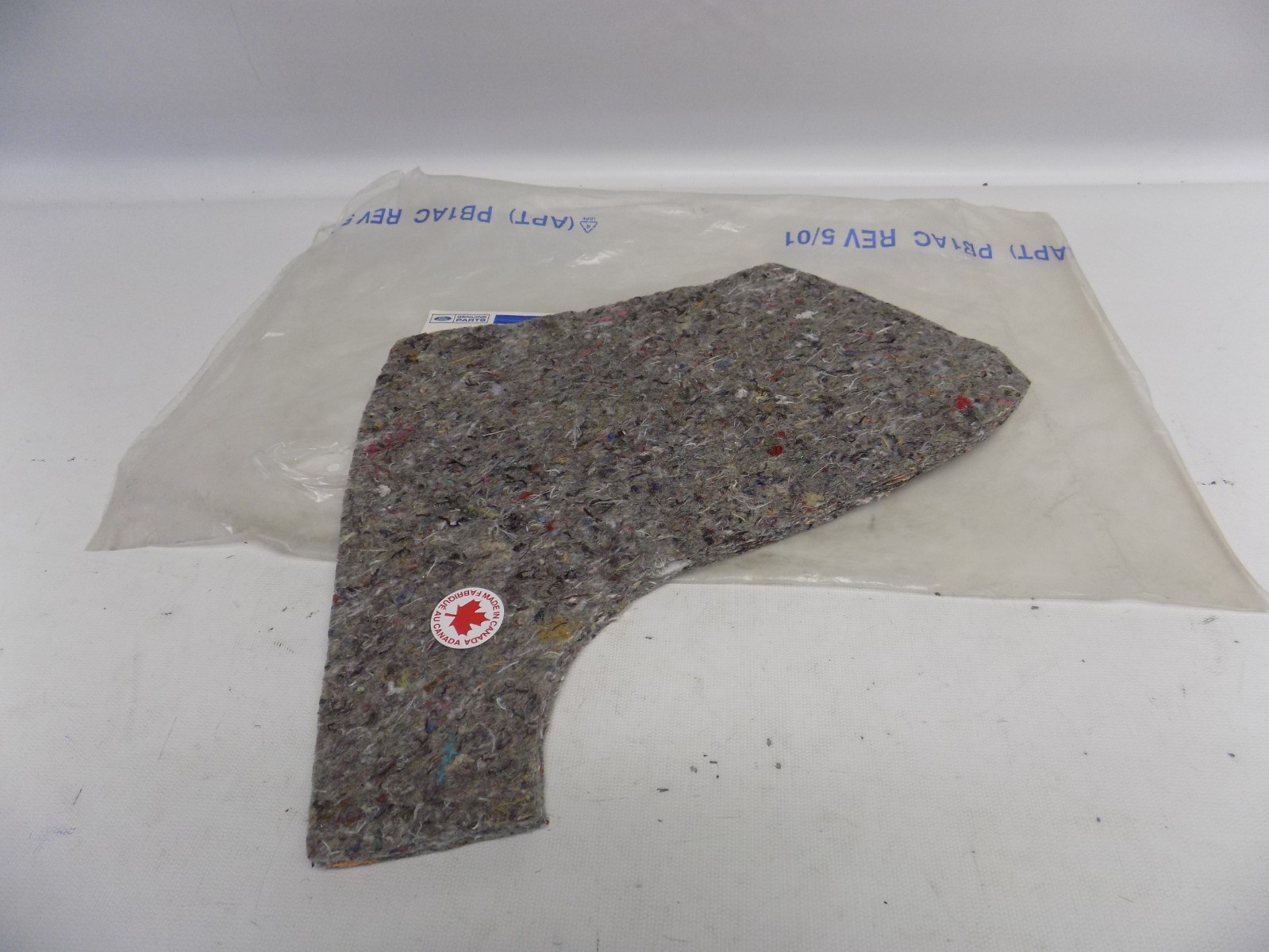

My Taurus had some sort of polyester fluff behind waterproof covering that worked good. The poly didn't absorb water and it would drain down from gravity so they didn't stay wet.
Looks like this
