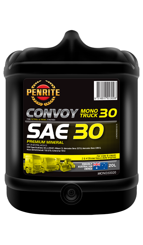

Can run a Mono 30
Penrite do one.

Have seen Delo Silver Monograde SAE 30 in the wild too.
It's also sold as Caltex SAE30 mower oil, and was what Rod Hadfield used in the Merlin engined '5 Chev
