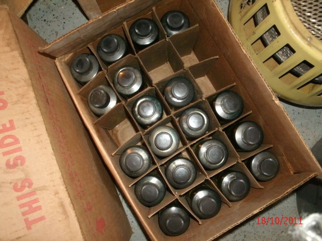

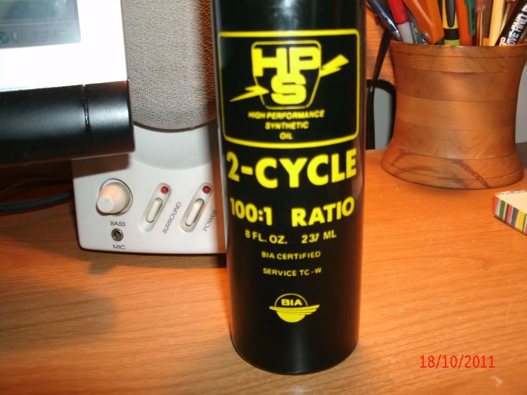

Im new to the site .I was at a auction and i bout 9 cases 24 in a case 8 ounce bottles of hps 2-cycle high performance 100:1 oil is this good oil i payed $20.00 for 9 cases i am oil rich if its good oil what do you guys think

i see it's TC-W spec??
yes couldn't find nothing that way i am here lol i heard that you guys are the best i think it is good seeing it is synthetic .I think it is around 1996 that what the shipping date is on the boxes thanks daman ps i hope it is good i have a lot of it lol

i hope it it good i have about 9 machines that run 2 cycle oil win i was at the action there was one guy that was bidding on it and he was out at $15.00 i got it and i loaded it up .The action was in flint mi. the guy was a dune buggy builder he died in 92 and his kids took over the biz. they were hurting for money and they action off all the dune buggy parts . He also was the land speed reorder holder in the vw what a v 6 buick 3.8l his name is bob wildell from swartz creek mi.he had alot of cool staff . it was on craig list flint mi. under garage sale cool stuff
It is BIA TC-W spec 2 stroke oil, which is an older spec for water-cooled engines. This stuff should really only be used in an engine that specifically calls for TC-W, which would probably be an older 2-cycle outboard of some kind. Air-cooled engines calling for TC-spec oil run hotter and TC-W may burn off too early and not provide enough lubrication. If it's air cooled and calls for TC-W or TC-W3 (probably a newer model engine), this might be OK to use. Outboards calling for TC-W3 *may* run fine with this - it's better than nothing - but it won't provide the same level of protection that the manufacturer requires.
In reality, any 2 cycle will probably run with it, but it's really made to be matched with an engine that calls for TC-W oil. Anything else and the results are hard to predict. Just my humble opinion, though.

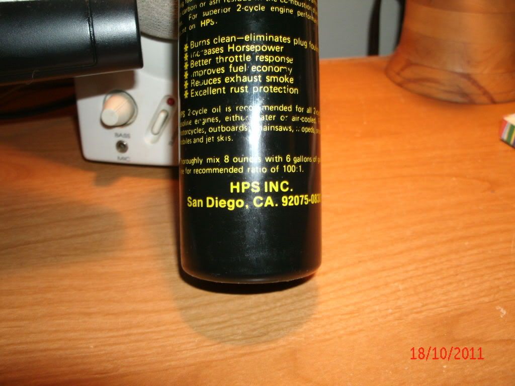

HPS is a company founded in the 1980s by Nelson Solerno. The 2-Cycle oil you have is a rebrand of Hatcol 2226 from Hatco Corp (now Chemtura). It contains a unique, very high lubricity polyol ester, and set the industry on its ear when it passed the TC-W tests at 100:1 back in 1976. The BIA asked that the tests be repeated, and when it passed again they established a proposed new specification called TC-W-100. When no one else could pass it, the new category was abandoned.
This product was discontinued by Hatco around 1987 when they exited formulated automotive oils.
Really don't know how good it is after all these years, so try it with caution in some older equipment to start, perhaps at 50:1.
