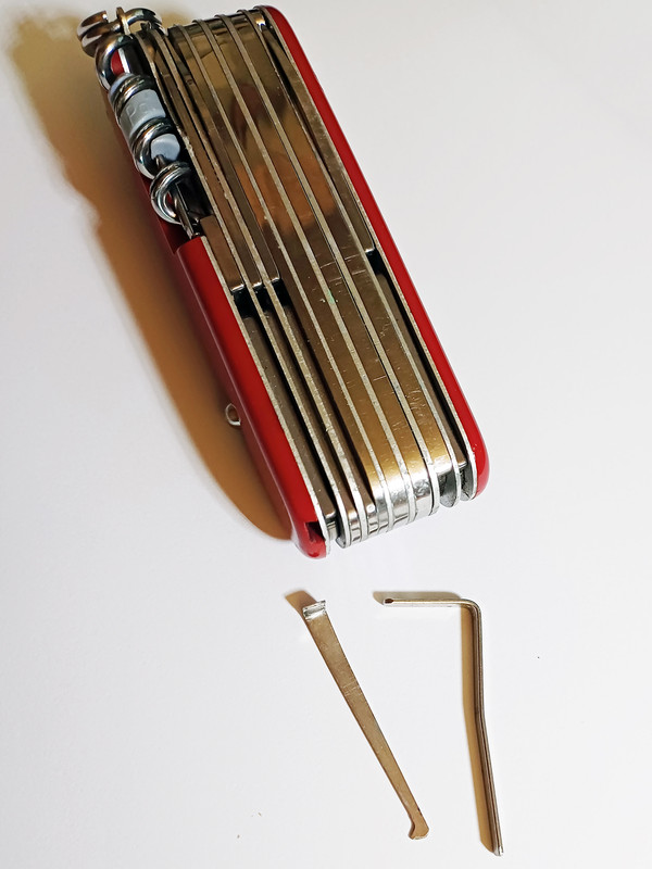

Lock-picking lawyer takes about 1.5 secs to open that basic Master lock. If you have any interest at all in picking up this skill now’s a good time. Cutting is actually harder than picking, once you get over the learning curve.
