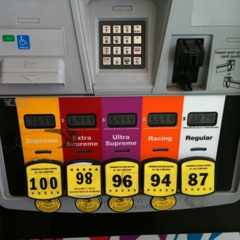

About the only way to get anything higher than 91 AKI in California is to use something with a blend of 100 AKI street legal race gas. There's this one place that has it, although I've been there when they were out of it and all their 94/96/98/100 selections were covered up/disabled. The sign said "out of race gas". This place is hilarious too as they repurposed an 86 octane label and use it upside down to make 98.
[Linked Image from s3-media0.fl.yelpcdn.com]
