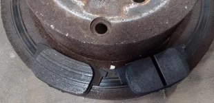

What makes brakes wear like this?
Rotors rust while the car is parked outside. Ordinarily, the pads rub the rust off the next time the car is driven. But if it is parked for a long time, the rust can get thick and crusty enough that the rust eats into the pad instead of the other way around. As the pad is no longer flat, it doesn't touch the rotor in the rusty area and the rust expands.
A significant "ring of rust" will decrease braking performance and it is not OK to leave it.
Blows my mind a bit that the rust is more "durable" than the rest of the rotor surface but this explanation makes as much sense as any.
I can feel "grooves" in the pad over top the rusty areas. Too bad the previous owner just did a pad slap.

Looks like how the rear brakes looked on our fleet explorers in the mid 2000's as they aged... They did not see a huge amount of miles and seldom were washed, and fleet maint was not great... Narrow wear patterns on the rear rotors with everything sticking...
Sorry, my original post wasn’t clear.
Yes, at least 1 caliper pin is frozen and another is extremely dry. Pistons push in OK.
I pulled everything off last night so I could figure out what I needed to order. I decided to get a full set of pads with clips, rotors, and caliper pins.
The pads are the correct size but they aren’t wearing the entire surface of the rotor. I was trying to understand what causes this to happen. The rear brakes (rotors on the right) were the worst as SC Maintenance observed.
Also, the parking brake wasn't adjusted properly and didn't hold at all, not a good thing in a manual transmission!
But overall, the car is in great condition. Can't believe I was able to pick it up for $1200. Only one rust bubble above the left rear tire.
Remember that you wipe off caliper pins. But if there is rust then replace. Don't sand with emery cloth or wire brush. Rust means the plating is going in the rusty spots so replacement is required.

It's just rust creep, sure you may have pins locked up due to lack of driving and other maintenance being neglected but once rust creep starts it's really tough to stop it. the rusty portion of the rotor is abrasive and wears the pad easily so it's very tough to get it to shine up again by just driving and using your brakes.
I have gone to extreme lengths and even wire-wheeled the area until it's smooth and painted those portions of the rotor to prevent rust until the pads wore into those areas again, but for the most part that is a fools errand.

What did you end up doing with the brakes on this Scion TC? I hope you replaced the pads and rotors, I'd love to see a comparison of new and the old pads.

Yes, pads and rotors all around. There were two caliper pins totally froze up so I ended up putting a new bracket on one of the front wheels because it was totally filled with rust. I'm still waiting on a new bracket and caliper for one of the rear wheels to come in from Rockauto. That one was froze up so pad that I can't even get it apart. I can take a picture of the new and old pads for that wheel for comparison purposes.
