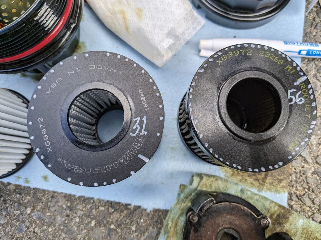

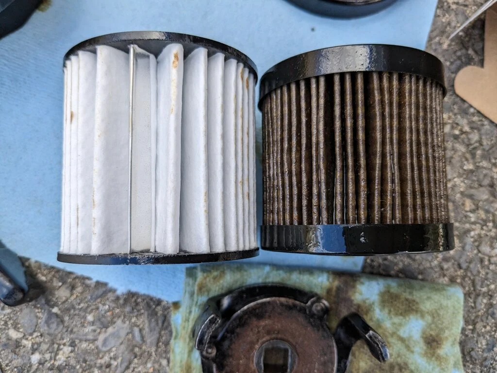

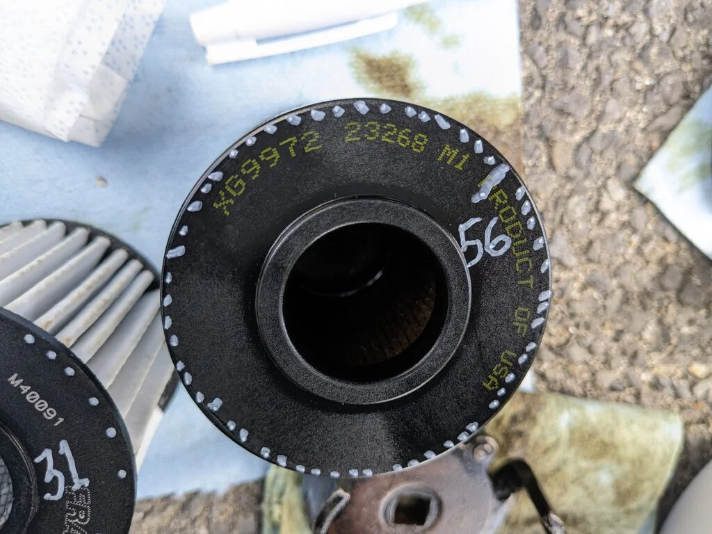

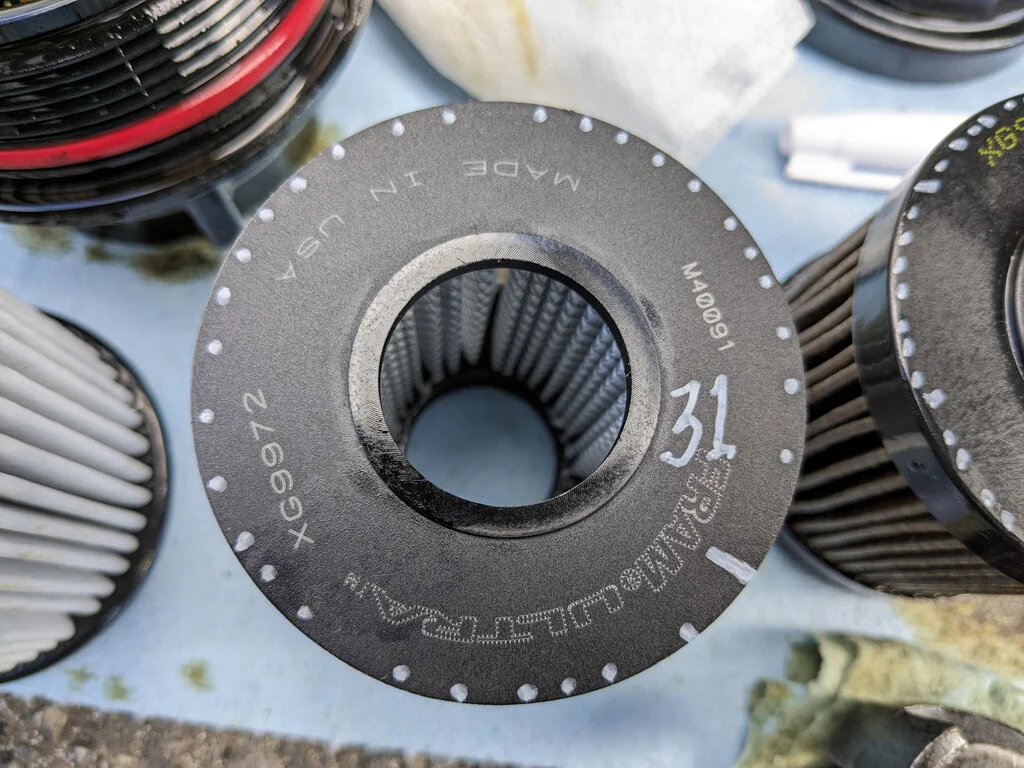

I went to change the oil in my 2015 Toyota Camry, 2.5l 4-cyl. I have always used the Fram XG9972. I pulled out the old filter, you can clearly see the markings as XG9972. Look at the comparison to the XG9972 I just bought yesterday at Walmart. What are you thoughts? Did Fram change the build? 56 pleats vs 31 pleats?
End of 2022 build compared to early 2024 build?

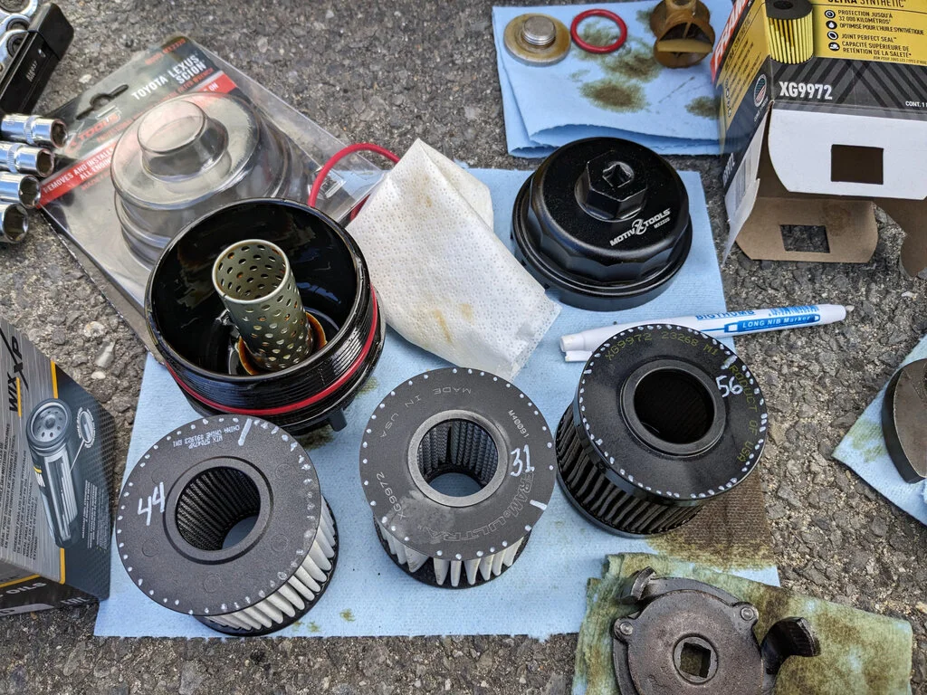

Compared to the WIX 57047XP with 44 pleats:

This new filter was a production change & removed the wire backing that was previously present. The new product should have good enough support & work well for your application. If wire backing is still wanted then you'll need to buy the Fram Endurance from Walmart if they make one for your Toyota.
The new one likely has the sprayed-on synthetic layer over synvblend medie “featured” in the new Ultra. Actually the old version looks a lot like an Endurance or Royal Purple-wire backed white all synthetic media-another cost cutting move, from the looks of it.
