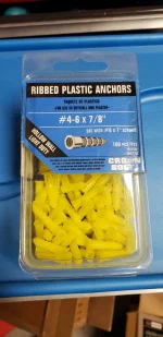

Once you get the damage ironed out, you can use plastic drywall anchors as snap caps to protect the chamber opening when releasing the hammer before storage.
