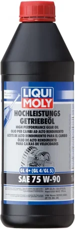

The only 75w90 GL4 available on the shelf of a US store is Liqui Moly 20012. Napa carries it. Search for LM20012
Looks like it's dual rated (GL4/GL5) which opens up majority of gear oils on the shelves as being compatible, since they are dual rated too. Valvoline comes to mind, readily available.
