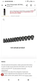

Don't spend that kind of money. It's just not worth it on a tool like that. I have several sets of these, and they work beautifully. Both sets together are $10.00 bucks.
If you want to up the quality a bit they offer these as well.
I have this set but with matco stamped on it.
