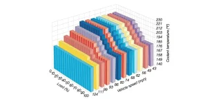

My bmw e90 325i has done a lot of 120mph long runs on the factory eu 5w30 ll04 spec without problems.
Modern cars with map controlled thermostat lower the engine temp and thus oil temp when more power is required. See picture:
So the oil doesnt really see a lot of high temps on modern cars with high loads.
If load is low they let the temps rise to decrease drag so the oil should actually degrade more when the car is driven slower.
But older simpler cars do get hot, especially without heatexchanger.
