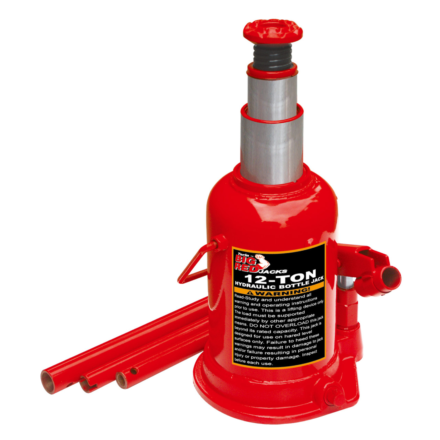

I recently replaced the clutch in my Civic. Being lower to the ground you have to raise it a lot more than a Taco. Used this 2 stage bottle jack that goes from 9 to 24 inches,
and 6 ton jack stands,
then a transmission jack as posted above,
Harbor Freight has many to choose from, but beyond standard jack stands, I suggest typical transmission jack, not what you have showcased in your post.
