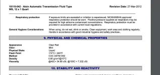

There was a MSDS/SDS of this same fluid in 2012 showing kv100 around 7.332 ish and kv100 of 34.88, I am not sure if the product has been reformulated since then and or if that was a false sds sheet or something but I attached that as well. Now it seems like the fluid has the specs above of 5.8 and 27.93. Maybe it was CAFE or maybe the values on sds are false but idrk.
