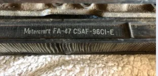

And here is what I put on top of the engine: It's a genuine Buddy Bar 3X2 intake. I'm pretty sure the Motorcraft air cleaner is long obsolete. Don't give me a sermon on stupidity. I was a teenager who was invincible. :D
The 351W was an adequate engine for a pickup in its day, even if it was a gas hog.
