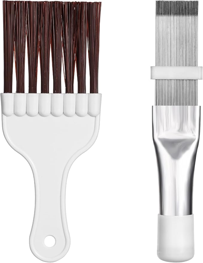

Newer A/C units have finer fins and all the combs I had did not work. I then purchased a set of approx. 12 size combs. None worked.
Then I bound this
You move the white "band" back to the handle and the small wires will find fins to ride in and straighten the bent fins. Amazing!!!

The one on the left is a brush. Made for brushing surface lint off of the coil, not for straightening fins.
Then I bound this
Where you get it from?
