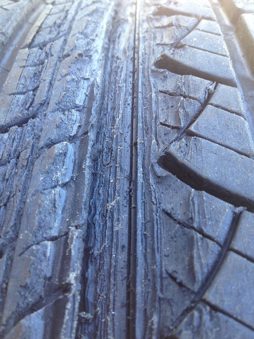

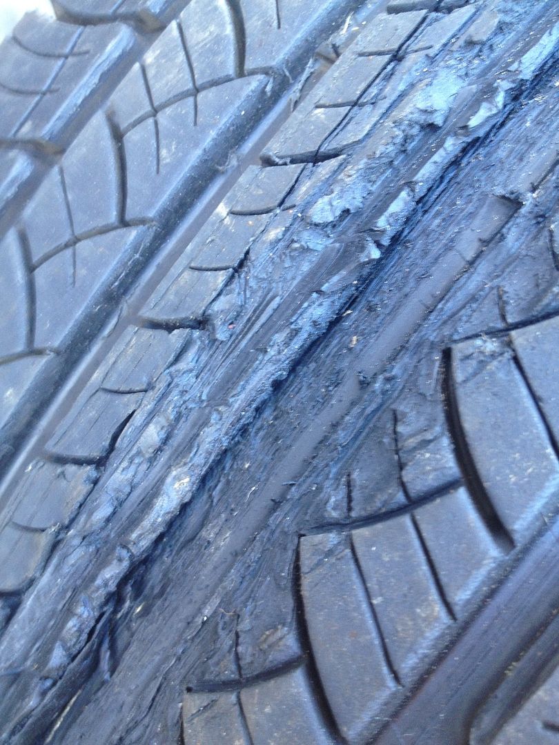

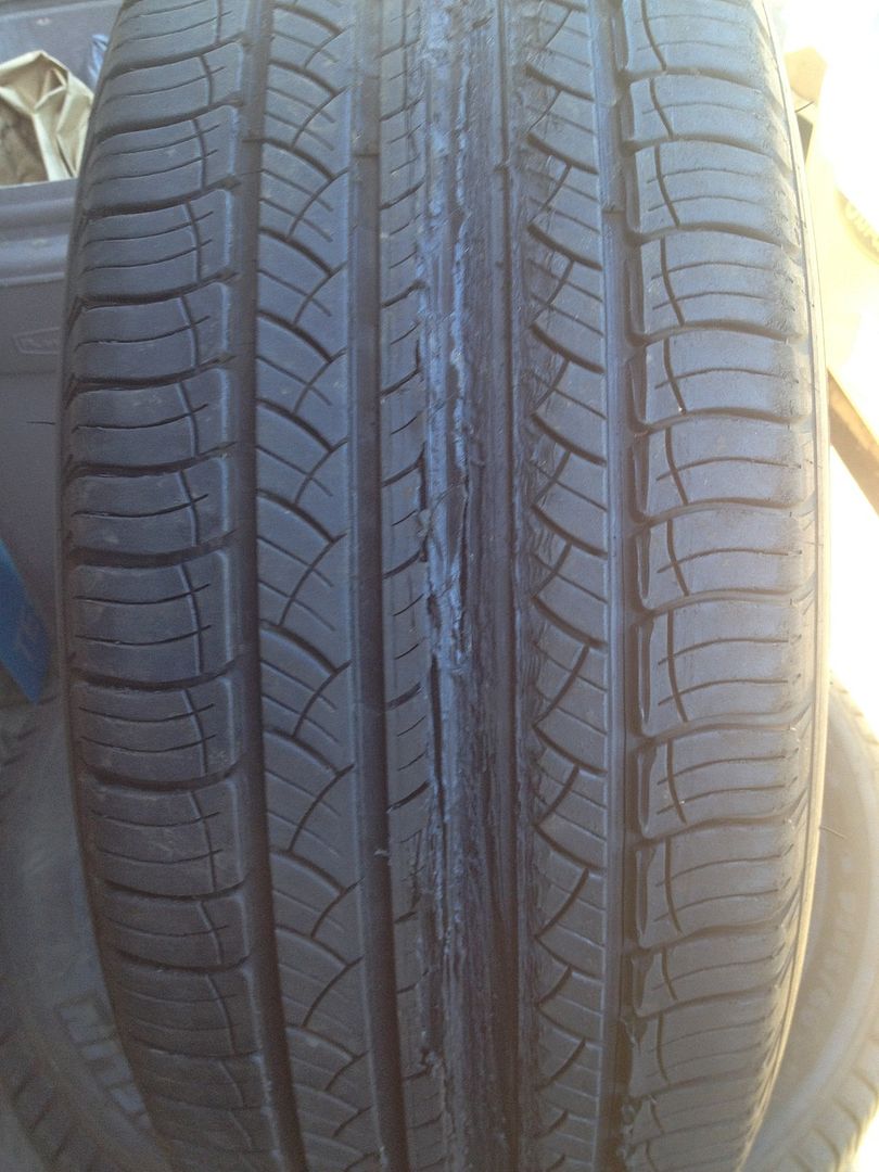

I am genuinely curious about this. Customer claimed it just "happened" with no explanation. I have never seen anything like this except for someone driving on train tracks. The tire is a Michelin Latitude 245/60/18 104H is anyone is interested.
I came in on the tail end of this deal. My only involvement was pulling a new tire off the rack. She bought tires a few months ago and expressly denied the road hazard coverage. Of course she made such a huge scene, even though her denying it was in plain writing on her old invoice, they gave her a new tire. Only people hurt in all of this was parts dept losing a tire out of inventory and the tech that got to put it on gratis.
The vehicle was either an Edge or a Flex.
Looks to me like a lot of wheelspin over some type of thing. When I was running out of date Nokian Hakka snow tires on a Mustang I got stuck on a dirt road going up hill. After a lot of spinning and sliding I made it out. And the rear tires had wear VERY similar to your picture.

She knows exactly what happened! That is why she made a scene.
that's certainly NOT a tire defect. just goes to show that if you create enough noise..... you will get what you don't deserve
Originally Posted By: turtlevette
Fender rub.
+1. I did something like this to a tire once. I jumped an incline (accidentally), flew probably 45 feet (felt a lot longer!), and landed hard. One of the front tires hit hard up against the fender and left a gouge around the tire, near where the sidewall meets the tread.
Going by that picture I would guess it was scraping up against something for a while and made lots of noise. My guess is rear tire, trunk loaded down with something heavy, tire rubbing on a bolt or something inside the fender.
+1
To me, this looks like a drive tire that has spun on something sharp when they were stuck. So...was this a drive tire or just a follower?
Indeed fender rub..i have that on side of my summer tires..i need to roll the fenders..weird place to rub fenders..unless lowered alot and tires exceed fender alot...
