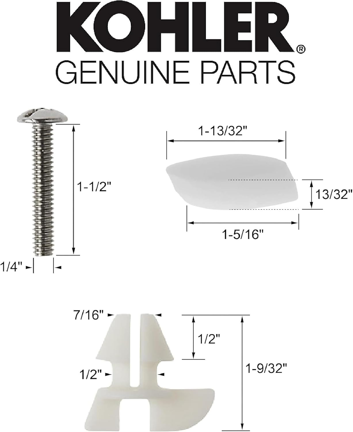

I'm a bit impatient so I went out and ordered this. It looks like the right bolt/nut pair combo for the Quick-Attach hardware. Less than $4 and with Prime there's one day shipping without a minimum. Worst case scenario is that it's not the right nut and I can return it without opening the package.
KOHLER 1239016 Seat Assembly Hardware Pack, Unfinished​
https://www.amazon.com/dp/B015JYRA8G
All the toilets in this house are Kohler and the seats all use the Quick-Attach hardware. Kind of different where the seat can be wiggled off (ostensibly for cleaning), but it has to be deliberate.
So the replacement hardware kit arrived. Way too much packaging though. One big plastic bag with the part number printed on it, and a smaller bag inside with the warranty into and basic instructions on how to attach a Kohler Quick-Connect seat. Just two metal bolts and two of those weird plastic wing nuts with a cone shape. No washers. I had it delivered to my parents' place and I was there. Odd watching the location of the Amazon delivery van in more or less real time, which I could do in the Amazon app.
