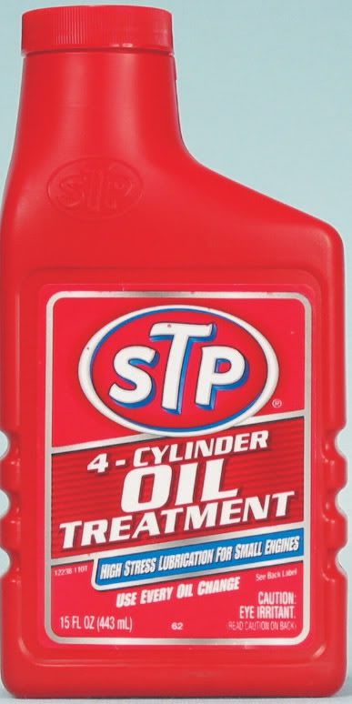

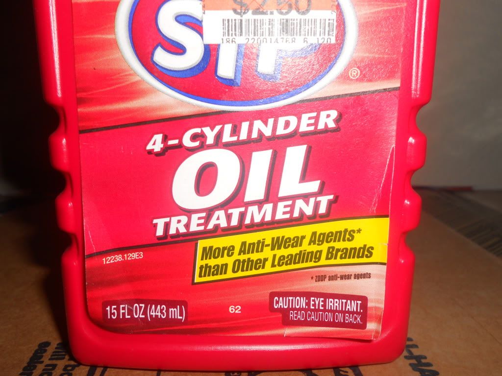

I just sent a sample off for oil analysis of the Biglots STP 4cly treatment today. I figured it's time for a up to day VOA on this stuff, I added some to my 2000 Daytona 500 Grand Prix GTP on top of Q 4X4 AND SUV semi synthetic 10W30 and I am seeing a solid 2mpg gain in fuel economy and the car is running much smoother and I beat this thing up pretty hard. Added to our Altima as well on the same oil, don't drive the car so don't know the fuel economy change but will check. Wife says it seems smoother.
From some digging around on the net it's supposed to add about 380ppm zinc to 5qts of oil. But the current VOA's I found vary by as much as almost 1800ppm on the zinc.
So we will see what happens hopefully by next Friday.
Here is the bottle from Biglots.
Not to be confused with this bottle which probably has less or little zinc in it.

I used to run that red-bottle STP in my cars 10+ years ago, when it was sold up here. It's a LOT thinner than the regular blue-bottle STP.
It went away b/c it just never sold, while the blue-bottle stuff STILL sells by the boatlaod, ever today. Lots of folks convinced it is a real fix-it - my BIL just added it the other day to his Blazer 4.3 V-6.

I have never seen the red stuff though. Is the blue the same but thicker,what I mean us are the additive content the same?
The Bottle of STP has less ZDDP additives and a much higher viscosity, You can tell the difference if you pour them side by side. The RED 4cly treatment did stop the rear valve cover gasket leak I had on my Grand prix Daytona, I no longer smell burnt oil on my manifold. (common GM 3800 series engine problem)
To me at $2.50 a bottle that adds just under 400ppm of Zinc to 5qt of oil according to the VOA done by Blackstone years ago, is a good deal.
I'm still waiting to see what the VOA I sent in comes back as, just to be sure it's the same formulation.
