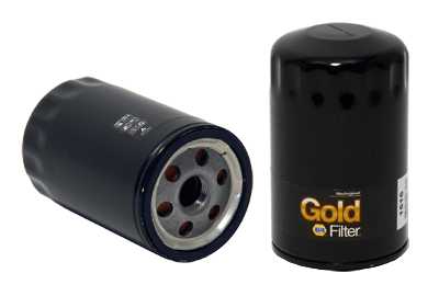

Change oil immediately with fresh Castrol GTX and an oversized filter such as Napa Gold 1516, which has the same bypass valve and diameter but 1.4" longer than OEM size.
You want as much capacity as you can get to store the sludge. Wix filter's thread end bypass will also help since sludge deposited won't be washed back into the engine when filter media is clogged and bypassed.

I will try to get an oversized filter tomorrow, if possible, a NAPA Gold 1516. Does anyone know if Autozone, Autobarn or Pep Boys typically carry them? I can get a ride from my father, but he is very busy so I cannot afford to use his time go to places that do not carry them.
A Motorcraft FL400 filter, or 3600 size from Supertech or Fram would work just as well and all should be available at your closest Walmart.

I've owned a couple 1MZ powered cars myself, and I once tried the oversize filter thing, just because I wanted to. I put an M1-209 on, but only ran it for about half an OCI. The filter on this engine screws onto the front of the block, below and near the exhaust, and with the large filter, at its closest, there's only about a thumb width of space between filter and very hot metal. The standard size filter on this engine is pretty large (at least compared to what they're spec-ing for similar engines today), and personally, I'd stay with that just for the exhaust proximity issue. I took some pix of this a while back; I'll see if I can find them and post one or two. Good luck with it. . .
ekpolk, you are right, it does become very hot in there and there is not much room. I guess I will stick with the Purolator PureONE oil filters that I have been using for the oil change and subsequent Auto-RX treatment. Does anyone have any ideas as to how many Auto-RX treatments I should run? I am willing to run as many as it takes to clean the sludge out of the engine.
