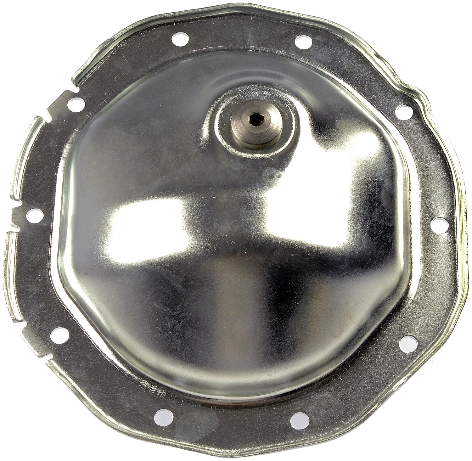

I sprayed the bolts an i thought i would give them each a tap in each direction and let them soak. They started moving easily with the ball peen hammer taps. I intended to just tap them, respray and tap them again tomorrow. They all came free!!
I am not touching the fill bolt, it only has 1/2 of the original square remaining. Too much work and risk of getting junk in the axle if it breaks.
I ordered the G2 cover, a felpro gasket and a tube of permatex 81182 gear oil gasket maker, just to have a tiny bit to hold the gasket on the cover.

I have watched youtube videos of people having to replace the diff cover when it started leaking ! :-(
Looking at the photos , my guess is you may not be too far from that happening to you . Glad you are replacing it . I would use new bolts , maybe even stainless ?
When you start back together with it , I would use the Permatex on the cover & not on the diff housing . If you ever have to take it appart , it may make it easer to get off . And I had rather do my gasket scraping , not bent over under the vehicle .
