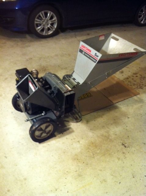

1991 Craftsman Chipper/Shredder with 5hp Briggs and Stratton
Out: Valvoline 30 weight
In: Rotella T6 5w40

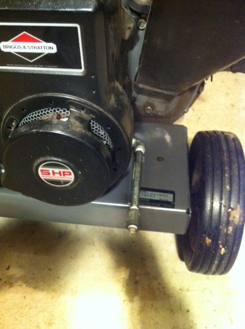

This chipper had the stupidest oil drain setup ever. There was no convenient way to drain the oil without getting it all over the machine. The plug was located in a bad spot, and the wheels are very difficult to remove. I bought some 1/4" pipe and made an oil drain pipe so changing the oil is much easier.
The Chipper:
The oil drain mod:
