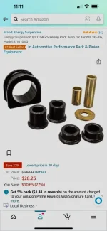

Same rack, didn’t even disconnect tie rod ends. Just replaced the bushings. Only code I’ve gotten in this was p0456 very small evap leak, accompanied by c1201. Reset those though and never came back. No other codes. Stock size tires and no suspension lift. I have sumo springs helpers in the rear to help it from sagging when towing, but stock height. I did the zero point calibration in the driveway pointing straight ahead but didn’t seem to make any difference. I’m confused on this.

Did you find the sumo springs influenced body roll at all? If so it would increase yaw. Was the steering sloppy before you did the work, possibly hiding the increased oversteer from the springs
Speed sensors seem to be ok but I’ll have to have someone else drive through the corners where it acts up so I can watch the scanner.
It’s hard to say how much they affect body roll. Definitely firmed up the ride in the back but got rid of the sag. I tow quite a bit and the rear is soft on these. They weren’t cheap so I’d be disappointed to be out the price they cost, but maybe I’ll take them off and see what happens. Good point.
The steering was sloppy before. Not sure how to share a video here but before the rack would shift side to side quite a bit. It’s a lot easier to keep in line now with steering feel.

No progress. Googling this again brought up my own post. Read live data and don’t see any wheel speed sensors dropping out or anything weird. Steering angle reads smoothly lock to lock. Yaw and acceleration rate sensors seem to read in accordance with what’s going on but I don’t know what numbers it’s expecting. Not sure if you can go back to rubber bushings but I see Moog has a kit that sounds like it’s not as stiff as the poly bushings. Debating giving that a try but this was a bit of a wrestling match as I remember and it drives nice other than the stability control being so overactive.
I had similar experience with a 2009 Tacoma. Started with a 1.5” lift but got worse when poly bushings were installed in steering rack. Did same as you cleared the yaw and steering angles. Nothing worked except installing a switch to turn off the ABS and VSC.
Well that sucks! Thinking about this had me curious enough to get the Import Direct kit from oreilly and changed them out today. Same problem persists. I’m wondering if taking it to the dealer for alignment might help rather than the chain tire shop. Les Schwab is where I had it aligned. These bushing have a smoother steering wheel feel than poly it seems but not as soft as the stock rubber.
