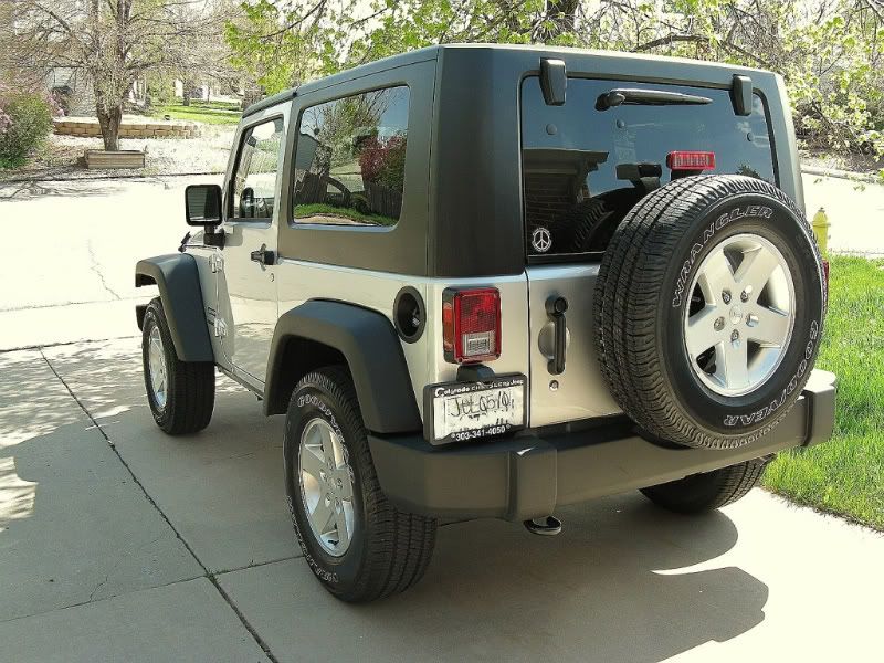

Here's some pics.
Very nice! The 3.8L is a stout engine and should serve you well. Stick with the recommended 5W-20. Valvoline Synpower 5W-20 or PP 5W-20 would be my picks.

Oh yea, very nice looking Jeep.
