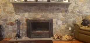

I also have a 2nd story fireplace with an external, enclosed chase. I have an issue with the firebox (I think) that at times causes some smoke to get into the room and of course disperse throughout the first floor. I had a friend stone the wall for me as he owed me a favor. In an attempt to control some of the smoke he closed in the top a bit. Didn't quite make it go away and it's just to small looking now.

Fireplace: Have it inspected and see what the repair cost is. If minor repair keep fireplace, repair it, have friend remove the layer of brick and stone opening it back up. If too costly a repair I am thinking of a wood stove insert. Fireplace depth is 26" and hearth is 20" wide slab of stone. I would not want anything sticking out past the hearth. House is 3600 sq ft spread throughout three floors. I'm not looking for a tank of a stove to heat the whole house. The first floor is open plan with wide stairwell and high ceilings so heat will readily make it to the top floor.

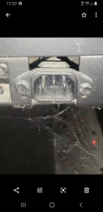

Having owned both wood and pellet stoves, I will say that the pellet stoves are cleaner and easier to control. The biggest downside is cleaning. The bigger the ash drawer the better. You mentioned the original power cord is missing. Every pellet stove I have seen had a hard wired cord. I would check with a pellet stove place to see what the required cord should be. As for the motherboard that will depend on the age of the stove and availability. Another key point is pellet capacity. Some newer stoves can hold quite a bit which reduces your time refilling.

So you would need a three prong plug on both ends? I must be missing something here.

My 14 and 12 year old sons are responsible to clean the basement......please excuse the cobwebs in the rear of the stove. This is the male end of the plug that powers the stove. It starts here. I'm hopeful that's what's needed. When I first installed the stove #2 heating oil was highly priced. I organized tractor trailer loads for me and a few guys at work. The stove has about 12 tons through it. Wasn't fussy and burned well. Auger and auto start worked well. Stopped using it after my son (toddler at the time) burned his hand on the glass.

Yes it does. I tried a Home Depot cheap replacement and got a light activation on the motherboard but that was it. I will borrow a cord from a pellet place to see if that is the issue first.
It does look like the old style computer cords. I’ll bet there is more to it than that though.
