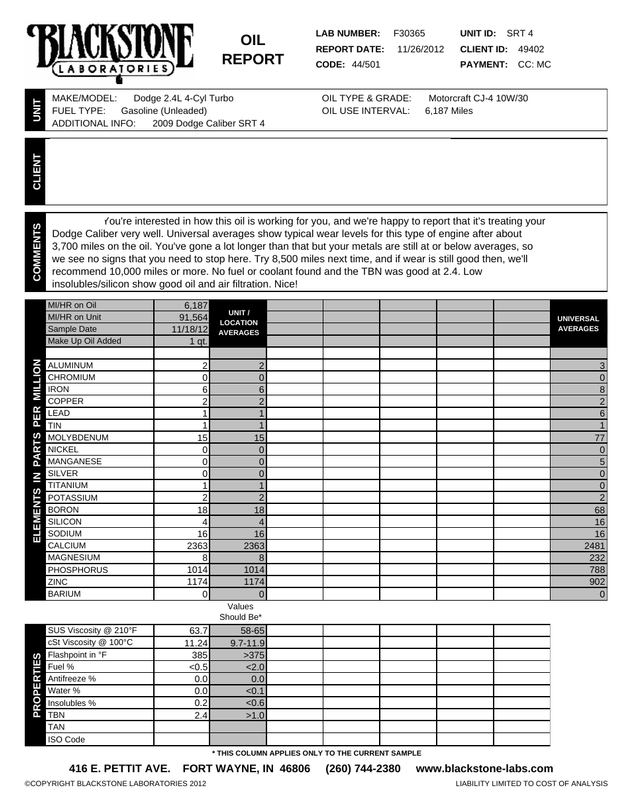

Here's a handful of UOA's where I've used HDEO oil, albeit 10w-30's not the 15w-40 you're considering. One is a for a 2000 Bonneville I had w/ the 3.8L supercharged engine. Other two are a Dodge Caliber SRT4 with 2.4L turbo engine. Neither driven very conservatively, the HDEO held up extremely well in all instances I've used it.
[Linked Image]
[Linked Image]
[Linked Image]
