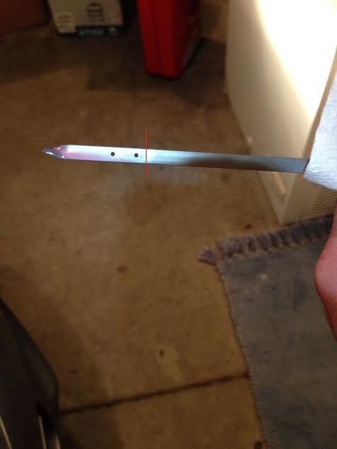

I have a 2012 Honda Accord with the V6 engine. I did a couple drain and fills(3.5qts each). I heated it up and checked the ATF and it was a tad low so I added maybe 1/8th to 1/4th of a quart and now it show a little high on the dip stick. It seems to shift great as it always has. Is this little bit going to cause any damage or should I jack the car back up and drain a bit out?
Here is a picture of when the fluid is on the dip stick. I put a line to make it easy to see:

That is fine on anything with a dipstick. The dipstick is not super precise, and full is a range, not a single point.
If you see a lot of bubbles, I would be concerned, but no bubbles and just slightly over the top of the full mark is fine.

If this is the temperature after a nice long drive I probably wouldn't worry about it.
Ideally you would suck up the extra fluid with an extractor.
Not a problem. You will see bubbles on the dipstick when there's too much in there.
