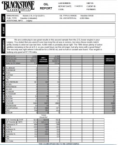

My reports showed little to no shearing:
PP 5w30:
T5:
There's no doubt these engines run well on an oil with an HTHS of 3.5+, and if you're engine/habits shears the oil I would would recommend it.
