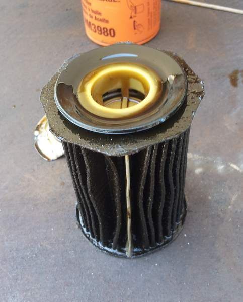

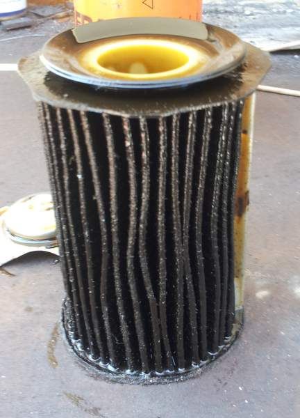

Got some of these for $1.25 ea. a while back, can't remember where now. This one has ~5300 miles on it. The nitrile ADBV was still pliable, and the construction looks better than the last Fram I opened.
You can see the little "cartridge" that holds the high-mileage glop. It seems to have all dispersed. I was a little concerned about the cartridge causing some flow restriction, but as far as I know, everything was fine. There's about 1/8" space all around it. End caps were secure, and the pleats weren't particularly wavy, either.
I remember that deal but I held off, Rock Auto maybe? The HM filter is a rip off at regular pricing IMO but a steal for what you paid for them. This one does not look quite as good as the last 3980 I opened but was certainly servicable. All orange cans are not created equal, but the 3980's are among the better ones.
IIRC Fram won't say exactly whats in the time release gel but has said that the additive will "boost" the oils TBN. If that is the case it can't be PTFE. Time release Boron or some such thing maybe?
At one time it was PTFE, I remember these on the shelves in the 90's.
It just had a weird gel that they squirted in the filter, and not the cartridge.
