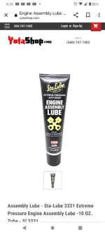

The way I see it is there is more risk when the parts are new and have not worn into each other as opposed to starting an engine that sat for a couple weeks after the break-in. The $10 bottle of assembly lube while maybe not absolutely necessary seems like a cheap way to gain a small margin of safety. Does anyone believe the motor oil would offer as good or better protection?
I've used Lucas oil stabilizer (the gooey stuff) and Lucas assembly lube, and sta lube assembly lube. On one engine I was helping my friend build he didn't install the oil pump drive shaft and the cam and lifters were fine because we had soaked them in assembly lube
