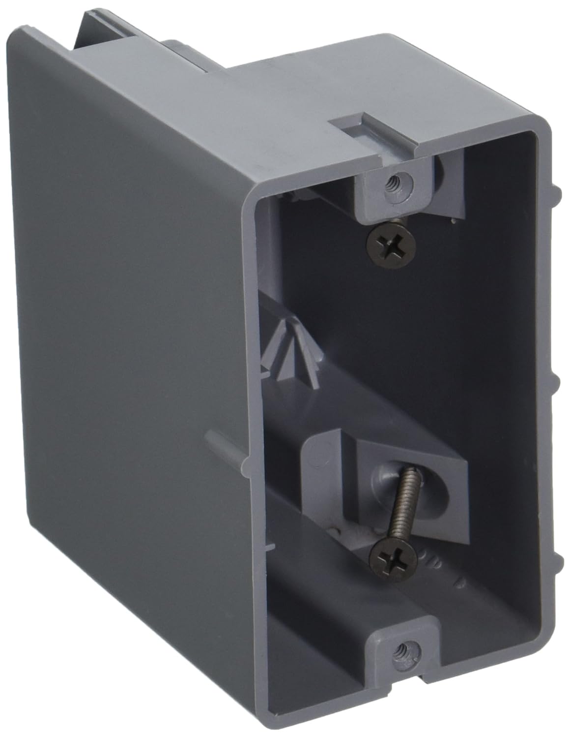

If screws inside a box aren't allowed, then explain how boxes like this exist:
[Linked Image from images-na.ssl-images-amazon.com]

If screws inside a box aren't allowed, then explain how boxes like this exist:[/img]
https://www.homedepot.com/p/Madison...ustable-Depth-Device-Box-MSB22/203343418
Quick look at Home Depot does say "UL Approved" but I don't (yet) see "NEC approved". So for all I know, it's actually not a legit usage. [I find that hard to believe but i don't know much about what standards regulate electrical box design, nor if there is any law prohibiting Amazon, Home Depot, Lowes, et al from selling code non-compliant boxes.]
Regardless, it looks like the screwheads would be recessed in application. That might be suitable enough for NEC.
I still think it's a bit over the top; it'd take quite the bur to rip through the insulation used. Not only that but I'm pretty sure metal boxes are worse for sharp edges. Then again, properly installed metal boxes would be grounded and thus safe, and thus nothing would be electrified if the insulation was compromised.
Edit: link to manufacturer: Link
It's not just those boxes either. Look at any handy box:
[Linked Image from images.homedepot-static.com]
Do you see any way to mount that box other than putting some screws through the back of it? These absolutely ARE allowed by the NEC. The only way someone could get shocked by having a screw inside the box is in the EXTREMELY remote chance of a conductor touching the screw, AND the screw is poking completely through a framing member, and someone touched it. The only way a short circuit could happen from a screw (in a plastic box) is if you had two conductors with insulation compromised and they were both touching the same screw head at the same time. Again, extremely remote chance.

I don't think the NEC approves anything. It is a standard and then listing agencies such as UL make approvals.
I just looked it up in the NEC. NEC 314.23(B)(1) says:
Quote
Nails and screws, where used as a
fastening means, shall be attached by using brackets on the
outside of the enclosure, or they shall pass through the interior
within 6 mm ('14 in.) of the back or ends of the enclosure.
Screws shall not be permitted to pass through the box unless
exposed threads in the box are protected using approved
means to avoid abrasion of conductor insulation.
So, screws ARE allowed inside boxes, as long as there are no exposed threads of the screw that can abrade the insulation. So, just thread the screws all the way in until the head is against the box, and you're good. If someone wants to dispute me and say that you can't put screws inside a box, please include your NEC citations, as I did.
