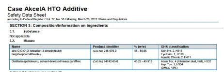

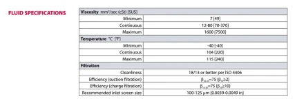

The case 440 hydraulic drive is a Sauer Danfoss. Mine is model M91-46146 soo assuming this is a series 90 pump. I have attached the spec sheet below from Sauer. So whatever oil satisfies that spec should be a reasonable substitute. I am aware there are drawbacks for using hydraulic such as water emulsive properties. Motor oil is far better in that regard and I would not mind to use 10w-30 as the manual states. I am just a little confused how the case dealer has the only 10W-30 oil that has the right properties. The dealer told me that case oil had the right anti foam and friction properties. Now keep in mind you used to have to add the HTO additive to motor oil to make it viable when case used to offer it. I have the spec for that attached as well. So what motor oil and hydro fluid will work?
