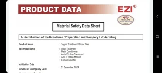

I read on Ezi Power Lube engine oil additive msds (screenshot of the document attached). I know it's not the exact recipe when we talk about msds but the substance definitely there

The post above makes it clear - there are hundreds of dioctyl compounds. Posting the MSDS with the word dioctyl has not reduced the possibilities among those hundreds one tiny bit. Until you gain some more information on which of those hundreds of dioctyls is in this, you’re wasting everyone’s time, including your own.
Perhaps look at it this way: if you knew a Lego model had bricks of eight, but didn’t know how they’re arranged, or what other bricks were present, you don’t know what you’ve got. Could be a pile of bricks. Could be the Millennium Falcon. But knowing the “bricks of eight” doesn’t narrow it down until you know what those bricks are stuck to, and how they’re stuck together.

Some terms or phrases in the MSDS should set off alarms immediately because they are nonsensical, vague, and ambiguous, as are most of the OTS additives from Thailand and elsewhere.
For example:
Metal Treatment - a metal treatment is when you subject metal to a heat treatment cycle or a forging process to change the alloy's crystalline structure. No external chemical treatment can do this.
Metal Conditioner - Conditions it how? Why does it need conditioning? Can I use my Suave Hair Conditioning cream instead? See above.
Anti-friction Treatment
Anti-Friction Modifier
Friction Modifier - ok so what is it, An FM or an anti-FM?
So I hope you see the silliness and the obfuscation printed on these labels.
Better to ask questions before you use it rather than use it and ask: Will this harm my engine or will it offer any advantages after the fact?
