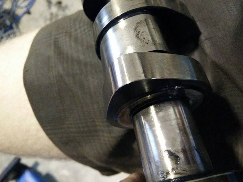

I bought this car with a wierd issue with the motor, had severe hesitation, kind of like it was running on 3 cylinders.
I've owned dozens of VW's over the years, but this is my first TDI.
Good friend told me what it probably was, but I didn't know it would be this bad...
Here are some photos of the damage:
One of the better lobes:
The bad lobe:
More scoring:
I think this happens most often from people putting non-spec oil in these motors, which require VW 505.01 minimum...

Only appropriate oil for PD (pumpe duse) engine is that certified with 505.01 or later 504/507 (LOW SAPS) spec.
http://www.oilspecifications.org/volkswagen.php
At least for 505.01 I have heard that contains special AW additive in it....that makes oil more "stay put"....and makes oil film stronger
That is important at start up of the engine because high amount of force is aplied on injectors by camlobes.....and if "regular" non 505.01 oil is used in PD engine that oil creeps away when car is not in use.....and that promote long term wear of PD lifters little by little every start up after start up of that engine.
It happens to them regardless of what oil you use, but of course the proper oil helps it last longer. It doesn't have to be a 505.01 oil. Plenty of people use Rotella T6 or Mobil 1 Turbo Diesel Truck and have great results.
