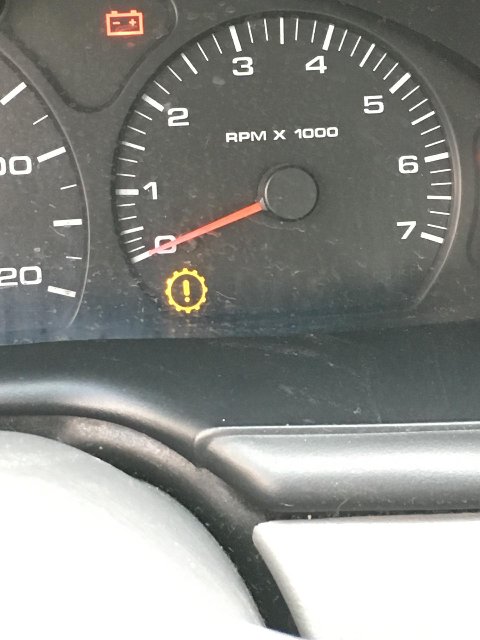

Yesterday it started running really rough and stalling. My son said it seemed to be missing on at least one cylinder. They were barely able to get it out of the convenience store lot and limp it back to school. He sent me a pic of the dash, I don't know Fords I and I don't know what this warning light is.

If I am looking at the manual correctly it indicates 'Check Transaxle' however I am not familiar with a sable.
See page 12 and 124 of the manual.

Check engine light looks like this on a 2001.

That looks like the "check transmission light" which they did have back then. I'd have her go to AutoZone/O'Reilly's/AAP and see if any codes happen to come up.
First step should probably be checking the fluid level and condition.
Is the "check engine" light on as well (should look like the standard yellow side profile of an engine)?

My guess is that if there is no issue with the shifting, then it might be a faulty sensor, but definitely check the Mercon V l(transmission fluid on these, very important) level and only use Mercon V. It's the yellow stick on the back driver side on mine. There is a transaxle sensor near the air-intake manifold on mine..

Here is an engine diagram for the Duratec motor, I think most Sables had the 24v but use the check above anyways. Incidentally, both engines are marked, the Duratec says it to the right of the oil fill. Also the page of the manual re. the light..

Anyway I was always told yellow dash lights are warning and red are you got a problem.

To my surprise the tranny is way overfull and the dipstick is plastered in bubbles. It's frothing in there. Bad. I am going to use my extractor to at least get that back down where it should be. I would imagine that was the cause of the tranny light, frothing is not good.
