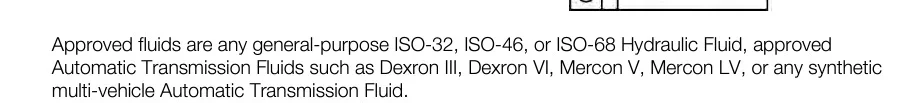

From their site:
Thanks all for the feedback. I was specifically asking about ISO weight and the current weather climate I live in (SoCal). Not what fluid to use. I'll probably just go with ISO32 weight like recommend.
