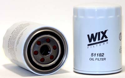

I am not a big fan of going with a considerably larger gasket diameter like you did with the Baldwin in this case, that is rather "iffy" territory in the filter upsizing world!
but if you insist, here is a Wix that will fit as well as your Baldwin and just as big
The gasket is not that much bigger than the stock one, about 1/10" bigger. I have over two million miles with Baldwin filters and never had one fail or leak and that is why I use them on my cars and toys. I have over 65k miles with this filter on my S2000 and my UOA's show my oil is cleaner with this filter at 8k miles than the oil was with the Honda filter at 4000 miles.
