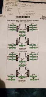

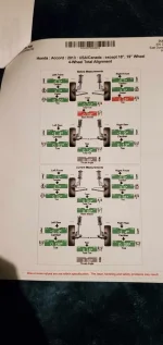

Too many responses to reply to 😂 . But, the tires were put on at 60k miles(Goodyear assurance max life) and rotated every 6k miles. I had both alignments done at the old dealership I worked at. The first alignment was done at 85,300~ miles. The second one was done at 85,600 miles. I had the alignment done because the car was pulling to the left. After both alignments it was still pulling to the left but not that bad. Hardly noticeable. Going to put the car on a lift tomorrow at my buddy's shop and see what cracking underneath.

You need to find a shop that has a hunter alignment machine that aligns down to 1/10 of a degree for some of the alignment angles and down to 1/100 of a degree for some of the other ones. And it has to align both the front and back tires.
Also they have to give the entire suspension system and steering system a good going over and also ask them to check to see if any of the rims are bent
