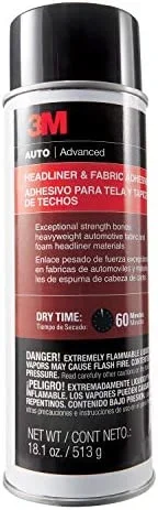

This is what I used when I replaced a few headliners. It will work great for the door panel material.
Is that can the 77 spray? It is the only one I see on the 3m spray adhesive page, that is black and red, but its worth making sure:
https://www.3m.com/3M/en_US/p/d/b40071862/#variation3
There is the 3M spray adhesive I posted and the 77 brand that you posted.
I have never seen the 77. What I originally posted is all I have ever used. :unsure:🤷‍♀️
I would think the weatherstripping adhesive would work. I have had good results with a hot glue gun on many different applications. I put it right next to the duct tape haha.
Thanks for the recommendation. I decided to get the product you recommended. It went on quick and easy. We'll see how long it lasts, but I don't think that will be an issue. This car only has to last a couple more years....
