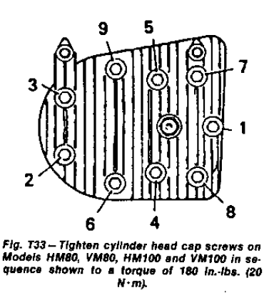

What's the recommended head torque? Any specific pattern to follow?
