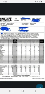

As a follow up here is the used oil sample analysis from this oil change. It is a screenshot so hopefully image is visible. Oil was sampled hot from oil pan drain hole. Universal averages show the 5.3L V8 and his is the 4.3L V6. I made him aware of it. Insolubles appear similar to previous oil samples
Wonder if they can get the silicon down any. Or try to get Universal mileage avg to get an idea how much silicon these produce to see if it's out of the ordinary. The avg Iron reading is 4.459 for all samples shown. That is not terrible but not exactly great & the Avg's that blackstone has would clear that up. Thanks for sharing!
Seems that Blackstone's "Universal Avg" wear particles number is just the average without any mileage reference. IMO, their Universal Avg should be expressed in ppm/1000 miles, that would normalize it for a better reference to compare someone's UOA numbers to, which should also be looked at in the ppm/1000 miles format.
Seems that Bkackstone's "Universal Avg" number is just the average without any mileage reference. IMO, their Universal Avg should be expressed in ppm/1000 miles, that would normalize it for a better reference to compare someone's UOA numbers to, which should also be looked at in the ppm/1000 mile format.
For the price they charge... That would be wonderful! It would save me from doing more math :LOL:. I'm fairly sure BS has an average mileage but they choose to state it only once in a while on the analysis results given to the customer.
I'll look into the silicon for sure. Intake seems well sealed from dirt but I'll check for sure. Thanks for the insight!
