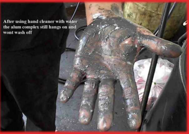

Can this be avoided? Yes, an aluminum complex will not mix and in most cases will say WATER PROOF. BEWARE! I have seen greases that said water proof on them and in fact were lithium based and also turn milky. So read the label and look at the complex being used.

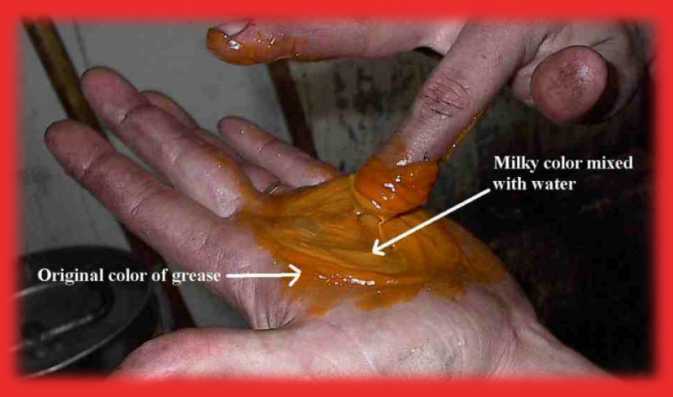

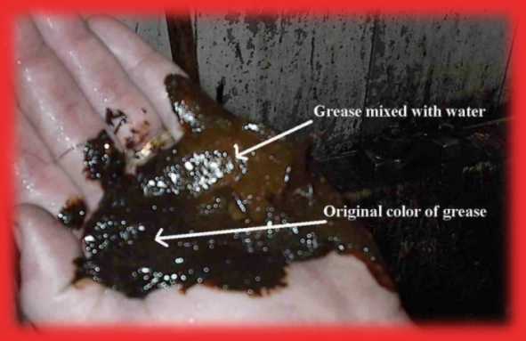

Another thing you can do is take a dab of grease, put into the palm of your hand, add some water, and mix with other hand, if it doesn't thin out and mix, your on the right track.
click on the pics to see demonstrations of lithium and alum complex
Lithium
Lithium
Lithium
Aluminum
Aluminum
