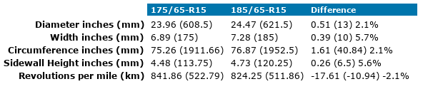

I am tired of looking for tires for my honda FIT, I am hating the size 175/65/15
I am looking at tirerack and I see a TRUCK load of tires in 185/65/15
I am inclined to Michelin/BFGoodrich (I like the rubber),
I have factory steel wheels with the 175/65/15s, I can put on 185/65/15 on these wheels?
I am guessing I might get a little rubs with extreme turning and possibly a drop in MPG.
So, will 185 work in my 175 wheels?

yes. with no issues at all.

Sounds like a "+0" upsizing.
Go for it.

206 60 15 ought to be about the same diameter. I put 15 x 7 Borbets with 205 60 15 tires on a Toyota which came with 195 70 14s. Made it a different car. No rubbing issues. Then I was able to put Avalon front brakes on it as well. Calipers from the Avalon wouldn't fit inside the 14 inch steelies. Does the maker know best... well, the maker put 15 inch wheels ON the V6 version OEM. And bigger brakes.

The closest tire size to OEM for your Fit odometer / spedometer / fuel economy that is readily availible is:
185/60r/15
Most people don't realize that the "r" size is a ratio. A 205/65r/15, for example, will have a different Diameter and Circumference along with the different Width so it affects your Odometer and Speedometer.
Most people just think the width measurement has no other bearing on the other specs but it is untrue don't listen to them.
If you have a warranty to respect, changing the tire from stock specs may cause you issues. It would be considered rendering the Odometer inaccurate, and they can claim greater wear on driveline components, transmission, and engine strain.
While this is all truly negligible, they can make warranty claims tricky.

The correct way to type/ write a tire size is P185/65R15. The "R" simply denotes the tire as a radial. As an example, ST205/75D15 is a common trailer tire size and the "D" denotes a bias ply tire. You are correct that the "65" Is a ratio. It's called the aspect ratio.

Most cars (all? DOT reg?) have clearance for snow chains on their stock tires. Going over stock by this much you'll probably do fine without interference but might not have room for chains.
175/65/15 is a dumb size. They should have just gone with 14 inch wheels.

Mileage - with wider tires the mpg will drop a bit - Non issue
speedo inaccurate - good point, and the fact that the ECU might not like it.
wheel well rubbing and chain fitment - rubbing, I have to be careful, I don't drive this in the winter so, chains no issue but it is good to know.
I am trying to get tires and keep atleast one on wheels are full size space in the garage as these tires are NEVER in stock locally.
Michelin Energy is ONLY tire in the size and it is not in stock anywhere.
My rear tires have a lot of meat as I do not rotate.
So for now I will get 2 185/65/15 and put them in the rear and move the rear in the right size to the front to avoid any speedo/powertrain issues.
keeping fingers crossed so the michelins in 175s come in stock soon.
FYI: honda fit manual has a sections for tire chains/cable I am pretty sure, I picked up cables for it last year, never had to put em on though.
THanks the input guys.

Actually this is a terrible idea doing just one axle in a different size. Will mess up your ABS, stability control, and change your caster alignment for the worse. Go all in or nothing.
