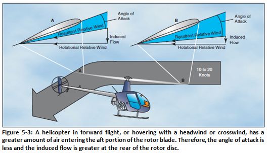

The forward advancing blade has far less angle of incidence, for less lift...
than the retreating blade does.
The is all automatically changed in the main rotor mast each rotation.
The "angle of attack" on each blade changes EVERY revolution.

Here you go:
