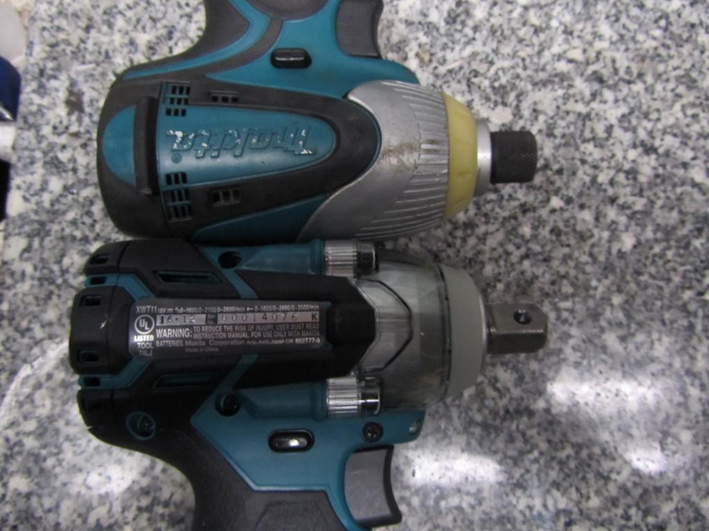

It is small, very small, in fact it is almost the same size with socket as the 1/4" model and its light even with battery.

The 1/4 and the 1/2 together. Notice the clear plastic protector on the 1/2

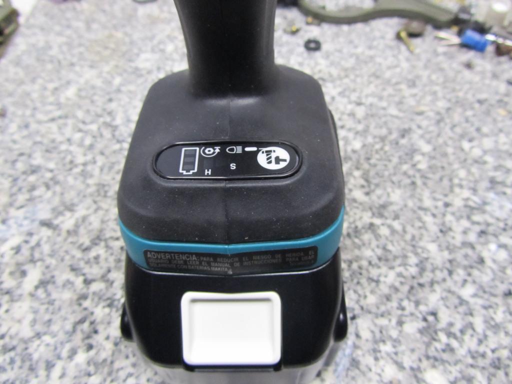

It has 3 speeds and variable trigger, there is also a light off feature by holding the button down down a few seconds. It also has a battery indicator which also works when older non star batteries are used.

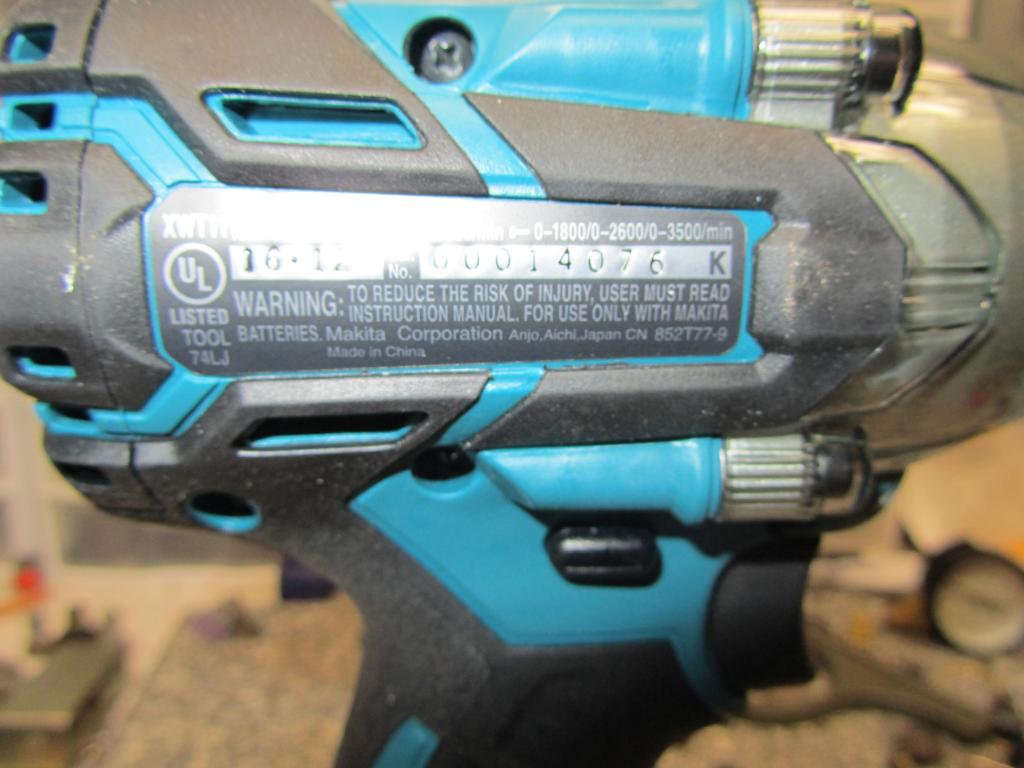

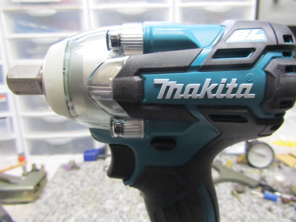

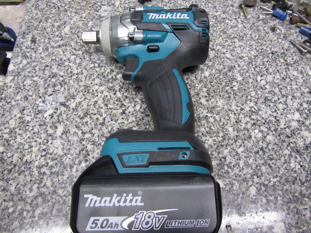

Some pics of the unit.
Makita claims more power with same weight as the 3A for their new 5A smart batteries AKA star batteries. The newest have a built in charge indicator. They are close but the physical size is same. The 4 3A batteries I have are all 10yrs and more old and never failed.

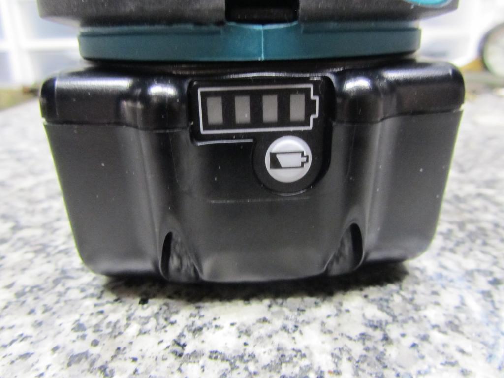

Some comparison pics of the batteries, the old non star batteries work fine in both old and new tools and vice versa. The Rapid charger charges the 5A in 45 min.
