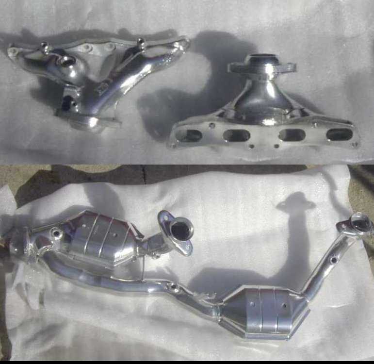

I had quite a bit Jet Hot coated on my V8 SHO.
The manifolds held up good and for the most part so did the Y pipe. The Y pipe flaked off in spots. It had 70+k miles on it. They suggest only new or you blast to clean before coating. Jet Hot just does a rudimentary cleaning before coating.

Re: Ceramic Coating for SS headers [Re: SHOZ] #4684853
03/05/18 08:11 AM
03/05/18 08:11 AM
Joined: Nov 2006
Posts: 19,937
MA, Mittelfranken.de
Trav Offline
Trav  Offline
Joined: Nov 2006
Posts: 19,937
Looks great! I sent new parts when I had them done.
ASE L1, Master. Deutsch Meisterbrief.
